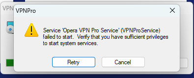

                Message: Service 'Opera VPN Pro service (VPNProService) failed to start. Verify that you have sufficient previleges to start services.

                    Same here. It first asked me to install .NET v.8 or above. I did. Then it started giving the sufficient privileges error. It started happening with the recent Opera update.

                        to fix insufficient privileges issue you need to install .NET v.8.0.16 exactly, it cannot be any other version. You can find it on Microsoft website. Please remember to reboot your computer and then try updating the VPN Pro client again.

                          That is an oddly specific version but it worked. I uninstalled the other .NET version and installed 8.0.16 and I was able to install VPN pro without getting the privileges error. Thank you.
                          Here is the .NET version link: https://builds.dotnet.microsoft.com/dotnet/WindowsDesktop/8.0.16/windowsdesktop-runtime-8.0.16-win-x64.exe
