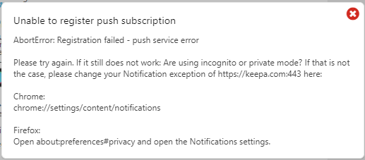

      web push notification stopped to work long time ago.
      Always get this error.
      "Unable to register push subscription AbortError: Registration failed - push service error"
      I don't know why they don't care...but at this point if you don't fix it just ditch the service instead of offering notification that won't work cause you do nothing about it

                @burnout426 Wow. So they know but they have no clue how to solve it? sounds reassuring..
                And isn't about just youtube..it happens in every site that offers notification in the browser

                        and i get notification. Still when i want to register to web push notification on Keepa.com, for example, I get the error message i posted.
                        If you force notification of course it pops out, but opera fails to register to the subscription to the service.

                          @wetsmurfette I can confirm the keepa.com issue. Had to go all the way back to Opera 117 (117.0.5408.197 was the specific build I tried) for it to work. By "work", I mean I was able to enable the web push notification setting on the Keepa settings page and click its test link to get a notification.
                          For Opera 118 and newer, I couldn't get things to work. Spoofing as Chrome or Firefox didn't help and the --disable-extensions command-line switch (to kill Opera's built-in extensions) didn't help. I also didn't see any flags at the URL opera://flags that would make a difference. It's just broken. With that said though, I can't tell if the Keepa issue specifically is actually a bug with the Web Notification API support in opera or if it's a bugs with the handling of some other Javascript code on the Keepa site. Either way, since it works in 117 - 102 for example, I'll file a bug specifically for the Keepa issue to see if someone can figure out the cause and hopefully, that might fix other notification issues.
                          On a side note, in testing some builds from 102 - 114, I noticed that sometimes notifications would stop working for Keepa in Opera. To make them work for Opera again, I had to delete the keepa.com string under the root/gcm/push_messaging_application_id_map node in the "Preferences" file in the profile folder. Or, I could goto opera://settings/reset and reset just settings.

                                        I just tested the keepa.com issue in Opera Developer 131.0.5853.0 64-bit on Windows 11 23H2 and it's fixed. See https://blogs.opera.com/desktop/2026/03/opera-131-developer/. Youtube notifications should work now too in Opera Developer.
                                          Mlipka 1 Reply Last reply
                                        • Mlipka
                                          Mlipka Opera @burnout426 last edited by
                                          @burnout426 Perfect, thanks!
                                            keepa.com notifications are working in Opera Stable 129.0.5823.44 64-bit on Windows 11 23H2 now too.
