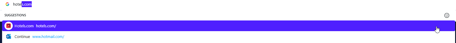

      Hello,
      I'm encountering a new behavior in Opera One that hasn't occurred in the past, despite using the same typing pattern for years without issue.
      Whenever I start typing "hot", the browser now auto-suggests hotel.com, and this suggestion cannot be removed. I’m used to typing "hot" and pressing Enter to quickly navigate to hotmail.com, but this new behavior consistently redirects me to hotel.com instead.
      What's more puzzling is that even after closing the incorrect tab and opening a new one, the browser still auto-navigates to hotel.com — as if something from the first tab remains active in the background.
      I’ve already gone into the settings and disabled everything related to suggestions or predictive URLs, but the issue persists.
      Browser version: Opera One (Version: 119.0.5497.141)
      Could you please advise on how to remove or prevent this unwanted suggestion?
      Thank you,

          @sgunhouse Hi. Thanks for the answer. It is indeed hotels.com. The suggestion is "hardcoded" and does not come from my bookmarks. When I hover my mouse, I don't have the X on the right end to delete this suggestion 4ef45ced-9728-4f45-808d-8744ec9dc73a-image.png

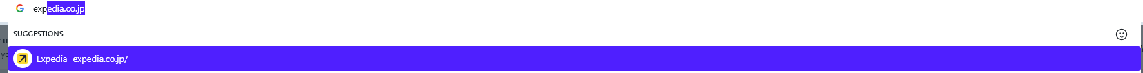

              First, i have the same behavior for Expedia. What is particular is the fact that both recommendations bring me to the Japanese web site of Expedia and hotels.com. I must say that I lived in Japan for few years, so that make sense in a way.
