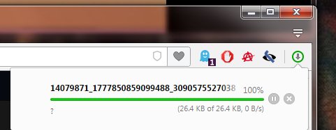

            @alobpreis, I'm not really sure what you mean. The download just sits at 100% like it's still downloading but it says 0B/s and never ends. https://pbs.twimg.com/media/CqxENv5WEAA8mn1.jpg
            Yes. Other browsers work fine. The file is finished downloading from what I can tell. Nothing I do to opera fixes the issue. On restart it says that there are downloads that didn't complete and asks if I would like to restart them. It happens in private mode as well.
