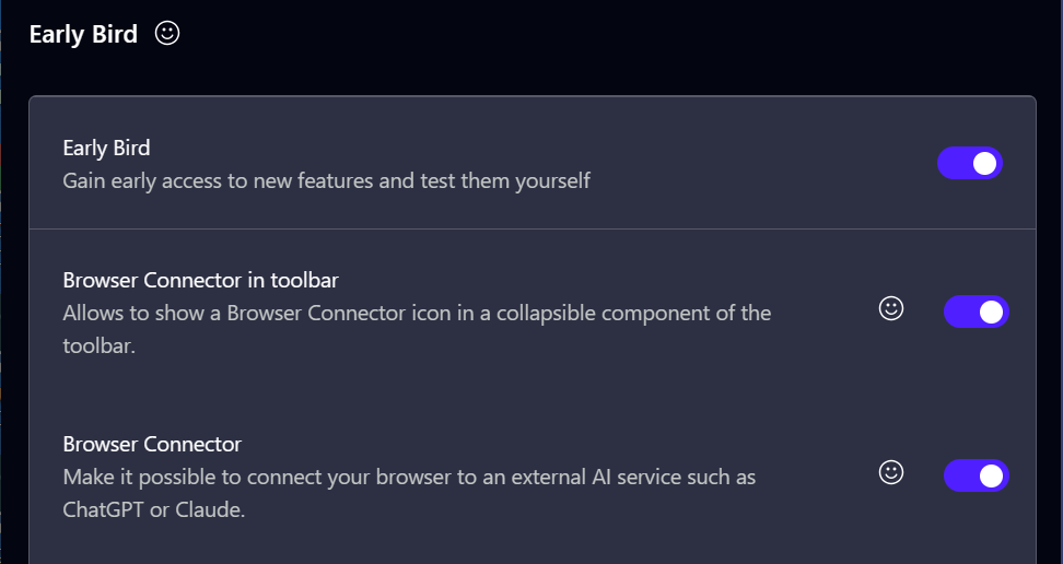

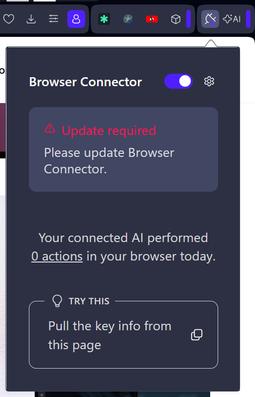

                      Even with uninstall/reinstall of Browser Connecter in opera://settings/ai
                      (Early Bird seettings enabled)

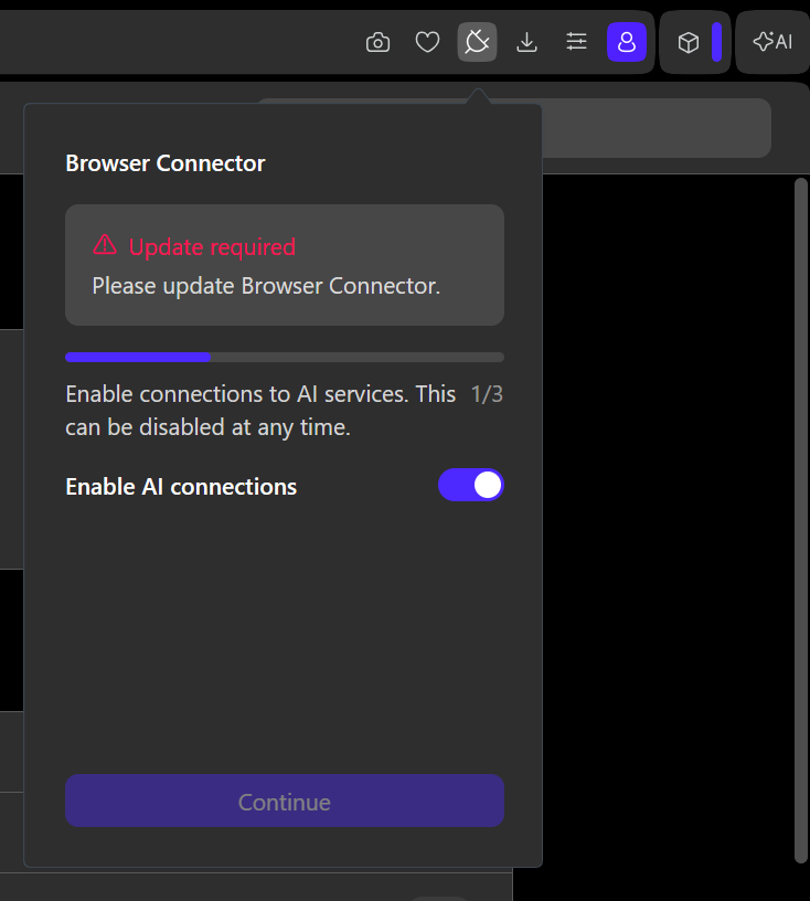

                      Fails on new standalone install (Opera Developer)
                      Even before the button moves from Extensions ToolBar to AI ToolBar.
