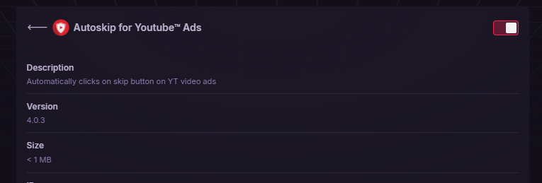

                                          @bovenbaas just wanted to share with you that this extension has been the only one to reliably reduce ads it takes a different approach can pretty much clicks the skip button for you but it also skips the video to the part when the skip button comes up so it's able to skip through the video so it's almost instantaneous it's able to skip through the ads. The name is "Autoskip for Youtube™ Ads". Not much creativity in the name but it works good. I will go ahead and attach a screenshot of what it looks like in my Opera GX see what the icon and stuff looks like.image_2026-07-22_044154475.png
