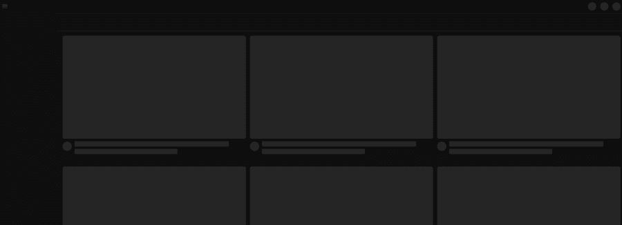

                                LEON13 last edited by
                                I have the same error on all the websites where YouTube players are embedded, and no method helped
