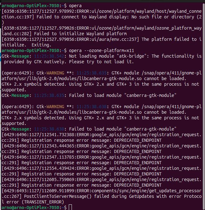

      Hello, same problem here after the last update from snap v. 124.0.5705.42 (stable version).
      Trying to launch from terminal:
      usr/share/libdrm/amdgpu.ids: No such file or directory
      [16571:16571:1126/203407.739781:ERROR:ui/ozone/platform/wayland/host/wayland_connection.cc:197] Failed to connect to Wayland display: No such file or directory (2)
      [16571:16571:1126/203407.739864:ERROR:ui/ozone/platform/wayland/ozone_platform_wayland.cc:282] Failed to initialize Wayland platform
      [16571:16571:1126/203407.740030:ERROR:ui/aura/env.cc:257] The platform failed to initialize.  Exiting.
      So, i can't use opera anymore... u.u
        alexbcrow7 last edited by
        It seems that its working on Xserver just fine. I ended up installing opera from the deb file downloaded from the site to use it with Wayland. The snap is not working on Wayland

                      Arno-Stein @Arno-Stein last edited by
                      @Arno-Stein said in Opera Ubuntu does not start after last snap update:
                      @karolek497 Same on my side, witz opera --ozone-platform=x11 I got it as a new installation
                      meanwhile I changed to another browser
